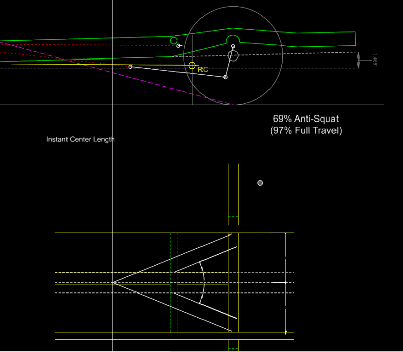

Anyhow I have started installing the rear suspension on my 56 F100 project, and have some antisquat questions. This truck is just for street driving, it is light maybe 3600 lbs, 4200 with passengers. It is light in the rear as well, with a 2:1 weight ratio front to back.
How does the instant centers location along the antisquat line affect the handling?
I would also like suggestions on engineering material for suspension setups, any good reads that explains this?
Here is how I have been modelling it up:

Yes this is a triangulated 4 - link.
I am more interested in handling characteristics than launching. What can I do to improve on this setup? Pull the IC down, or pull it down and back?

In my design above, I have the lower bars with fronts higher than the rear. However, these lower bars run parallel to the frame, and the uppers converge.
Does converging the top bars vs the bottom bars affect roll center? If so, how?

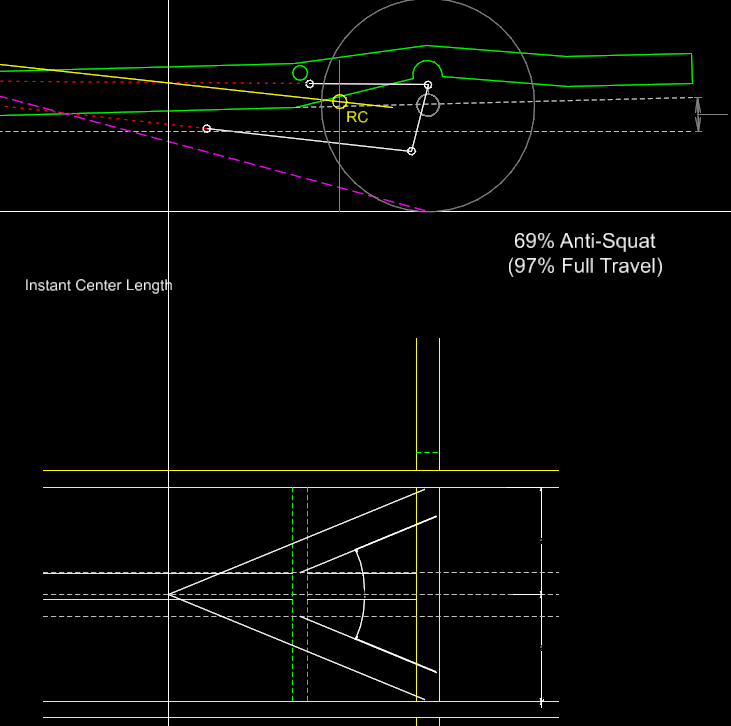

Am I looking at this correctly?
Assuming the convergence point is the same in both drawings, and the arms are just flopped the roll center changes just a few inches.
In this one, the lower arms are parallel and the upper arms converge to a point in front of the axle. (this lowers the RC rather than if they converge behind it, CORRECT?)
In this scenario the upper arms are parallel and the lower arms converge to a point in front of the axle. (Satchell).
Am I mapping this correcly?
Most such designs have the convergence at the axle end rather than the chassis end. Both will work. One way keeps the roll center close to constant height above the ground no matter what the chassis does, and the other way keeps it close to the same position in the chassis no matter how the axle bounces around underneath. What's better is beyond my pay grade. One way feeds loads into the chassis near each frame rail. The other way has control arms ending in the middle of nowhere unless you happen to have a good strong crossmember there.
As for the axle steering ... In side view, figure out the X (longitudinal) position of the axle 50mm into bump and 50mm into rebound (body roll). Now draw the axle in top view taking that into account, and keeping in mind which side is doing what when turning left or right. Is the axle "steering" in the same direction as the front (roll understeer) or opposite (roll oversteer)?
