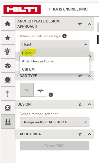

I paid for the subscription for Hilti Profis. Works great.
Only question I have, is if I dont want to use a profile for analysis, how do I tell the program that? I turn off the profile, then it tells me a profile must be added in order to do the calcs.
am i stuck doing it with a profile? I figure there has to be a way to go back to plain old anchor only design.
It sounds like you are in the "Advanced Anchor Plate Design" portion of the software. You can change this by assuming a rigid base plate in the following area:
