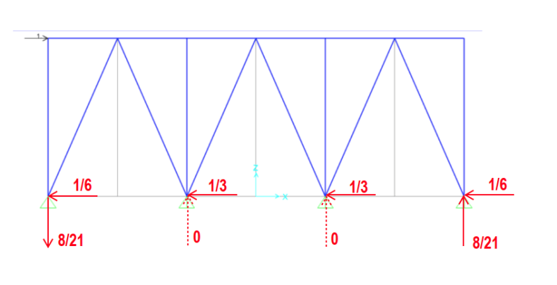

Unless you are considering axial deformation of each member, why wouldn't each inverted "V" resist one third of the applied force?
Considering a single inverted "V", with a load of 1/3, the horizontal reaction is 1/6 and the vertical reaction is (1/3)*8/7 = 8/21.

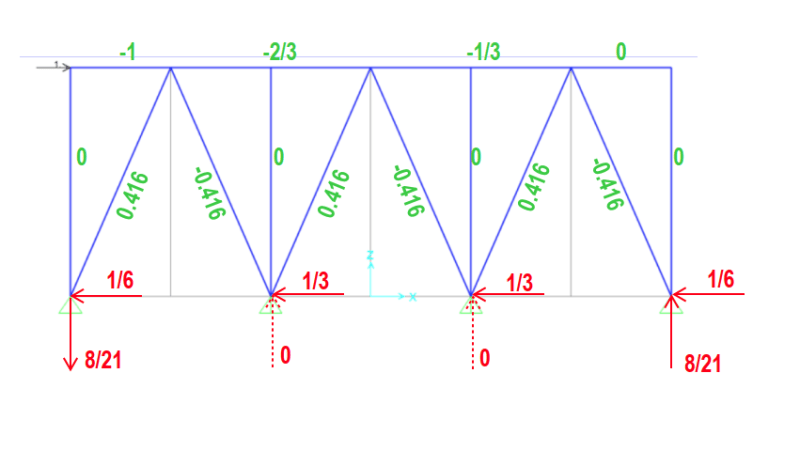

Neglecting second order effects (axial deformation) the red figures show the support reactions. The green figures show the force in the member (tension +, compression -).
If axial deformation is included, the forces will change slightly.
BA
GregLocock said:
I think you'll find there's a vertical reaction at all 4 of the ground nodes.
That is true, but the vertical reactions can't be evaluated without member properties because the structure is indeterminate, which means it can't be solved by statics alone.

BA, your reactions at the support make sense to me, but are you using a method to find them, or do you just make an assumption?
The reactions are based on the assumption that the top horizontal member is sufficiently stiff so that each bay takes one third of the lateral load. In other words, I am neglecting the strain in the top horizontal member in order to make the structure statically determinate. It is a similar technique to neglecting axial strain when calculating the reactions of a rigid frame, using hand methods.

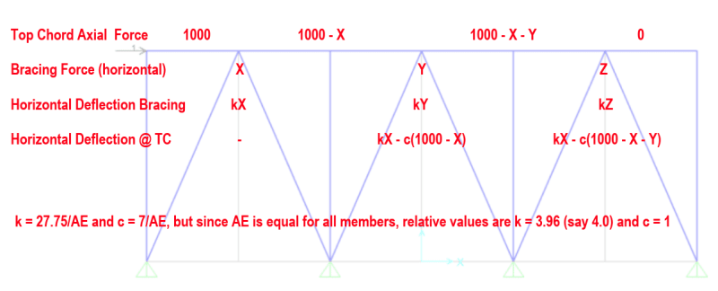

A typical braced bay will deflect as shown on the sketch below. A force H applied to the apex results in a deflection of 27.75H/AE (see below). That is a measure of the stiffness of each bay, taken separately.
A horizontal member with axial force F and length L will strain FL/AE, in this case, 7F/AE.
With that information, it should be possible to write compatibility equations in order to determine all forces precisely.

The example you provided in your last reply, how does it work if I have several bays?
If you have 3 bays, assume horizontal forces of X, Y and Z in each bay respectively. One equation is X + Y + Z = 1000N. You have two expressions for deflection (see sketch below), so equate them and solve for X, Y and Z.

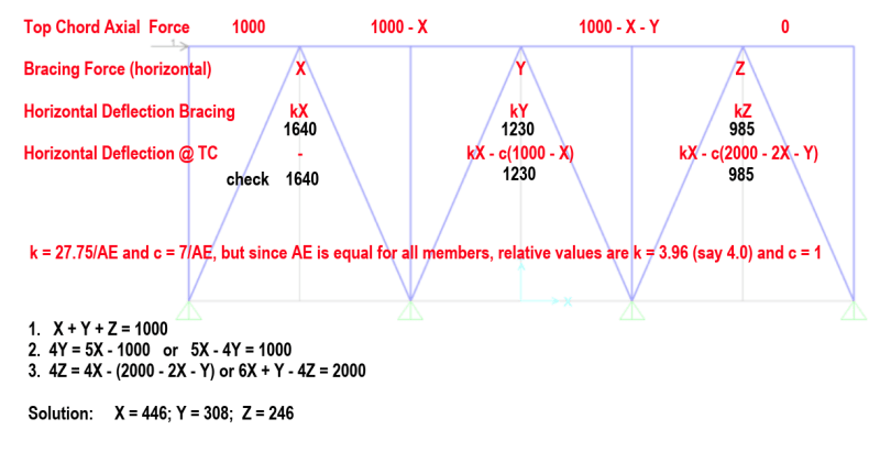

I had an error in the last term, which I have corrected below.
As expected, the force taken by each bay diminishes from left to right when the stiffness of the top member is included in the analysis. If the top member was increased in area, the difference would be less, but would still be evident. As it is, the first bay carries almost half the applied load.
Reactions may be readily calculated, but I have not included them.

Thanks for your reply BA, I just don't understand how you get the last line "horizontal deflection @TC", and how to you get c = 7/EA ?
1. c = 7/AE
Strain in the top chord can be expressed as FL/AE where F is the axial force and L is the length of the member. For a typical interior panel, L = 7m, so strain = 7F/AE or cF where c = 7/AE. When F is compression, strain is negative.
2. Horizontal deflection at top chord
Let Points A, B and C be the middle of each of three bays.
Point A deflects kX.
Point B deflects kX - strain in AB = kX - c(1000 - X)
Point C deflects kX - strain in AB - strain in BC = kX - c(1000 - X) - c(1000 - X - Y)
There are two compatibility equations, one for Point B and one for Point C. These, combined with the equilibrium equation (X + Y + Z = 1000) provide the solution to the indeterminate structure, 3 equations for 3 unknowns.
