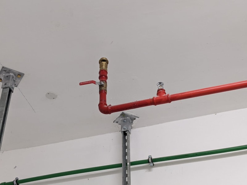

Air Release Valve Installation: Is there anything wrong in this installation?
sv879
Dec 7, 2018
68
Air vent valve should be preferably on top of mains to be able to vent more air.
The valve should be easily accessible. Is it located at a reasonable height?
Are you within the limits for unsupported pipe length from the last hanger?
