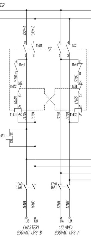

The control circuit is powered by two UPS units (UPS A and UPS B) with automatic transfer in case one fails. The motor feeder is supplied by an LV air circuit breaker (ACB), without a contactor. The ACB includes an undervoltage release (MN) and a shunt trip coil (MX).
Currently, when one of the UPS units fails, the ACB trips. However, I would like to prevent the ACB from tripping during the control power transfer between UPS A and UPS B. The control circuit diagram is attached for reference.
I would appreciate any suggestions!

Overkill.
If you are transferring between UPS units, your under-voltage release will trip during the transfer.
If you cascade the UPS units, Line-UPSA-UPSB-Load, then you will lose control power if UPSB fails.
Consider the case where you are running on UPSA and UPSA fails.
The loss of output from UPSA will initiate a transfer to UPSB, but at the same time will drop out your under-voltage release.
While the combination of a UPS and Under-voltage release seems contradictory and self defeating,I realize that a valid reason is possible.
If the application is so critical as to require two UPS units, it may be well to consider a battery system.

I attempted to set a time delay for the undervoltage release (with a delay longer than the transition time between UPS A and UPS B), but the auxiliary relay KA1 still caused the breaker to shunt trip. One possible solution is to eliminate the shunt trip and rely solely on the undervoltage release with its built-in time delay.

Actually the control circuit power to the MCC is fed from the UPS distribution board A and UPS distribution board B with automatic transfer happening in the MCC. (see the drawing below),
Why would we need to consider a separate battery system? Isn't the UPS already equipped with a battery system? Are you suggesting that using the batteries would enable a seamless, bumpless transfer as it is DC power?
There are points of failure between the UPS batteries and the UPS output.
You may use two battery systems, tied together with diodes or one battery system with twin charging systems isolated with diodes.
Either will give a bumpless transfer.
Another possible solution that may be much easier and cheaper is to change the under-voltage release coil to a DC coil.
Use a local bridge rectifier to power the coil from the AC circuit. Add a capacitor to the DC side to carry over the transition period.

I have the following opinion for your consideration.
1. The likely root cause is the DC supply from UPS A or B dropped to say < 50% during transfer. Attention: You may need a "Power meter" to capture this very short-time event. A simple digital multimeter may NOT capture it.
2. Observation: a) MX is an opening coil, NOT a shunt release. In most cases ACB can only installed with either a UV or a Shunt, but NOT both. b) the existing MN (UV release) is on 24Vdc.
3. The solution is to delay the MN from dropping out during UPS transfer.
Suggestion: Most ACB do have a simple external separate RC box for connection in parallel with the MN, preventing it from dropping out; for a short duration only. It is in their standard accessories, but is an optional item. Consult the OEM or read the catalog thoroughly. Attention: The local Sales office may NOT have the knowledge or has NO incentive to offer any advice or seek the factory for further information.

1. The control power is of 230V AC fed by 230V AC UPS distribution boards
2. The ESD relay, K2 (SIL 3 rated) is of 24VDC - always energized - when deenergized - the contacts of K2 de-energises the undervoltage release (MN); which inturn trips the breaker (designed fail safe). (not sure the U1(time delay unit) which is in line with MN rectifies the voltage from 230V AC to 24V DC); think it should as it is a time delay unit.
3. There is no voltage dip in the 690V.
4. The other low capacity motors in the panel uses motor contactor combination (Type 2 coordination), which dont use any control power from UPS (control power using control transformer downstream of the MCCB)
5. It is only this motor (ACB fed) experiences this issue during transition of UPS A to UPS B.
