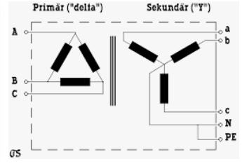

Dear All,
We are performing a transformer ratio test on a 1 MVA,33kV/400V transformer using a three phase transformer ration meter from a reputed manufacturer.The ratio meter is also showing the current (mA) in each phase in addition to the turns ratio value. During the testing, we found out that the ratio values are in acceptable range in all three phases. But current in one phase(phase A) is abnormally high. This high current is around 120 mA, whereas the current on other two phases is just around 12 mA. Is this an indication of an issue . We have tested many transformers before but this is the first time we see this kind of a very high current in one phase. Please assist.

But if it is possible I would measure the resistans over each winding separately.
A-B
A-C
B-C
they should all have the same resistans
and then
N-a
N-b
N-c
and they should also have the same resistans.

A turn to turn short is to be suspected in A phase. To confirm, conduct single phase excitation current measurement at 10 kV as explained in C57.152 standard.
Being only 400 V transformer, only 230 V is required instead of 10 kV.
