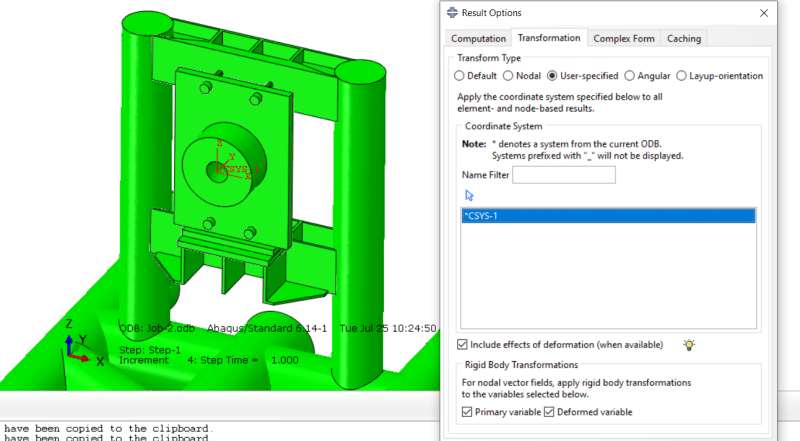

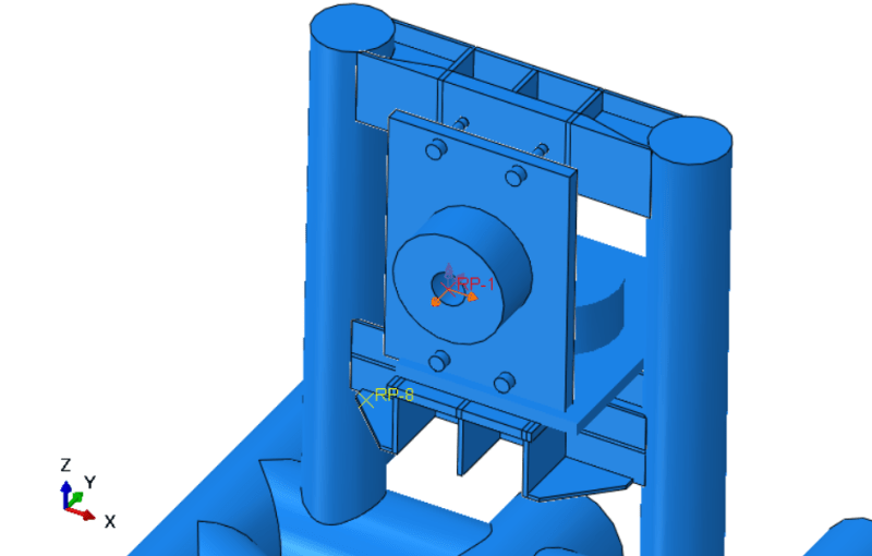

I have applied nodal loads in RP1 as shown below. Forces and moments.

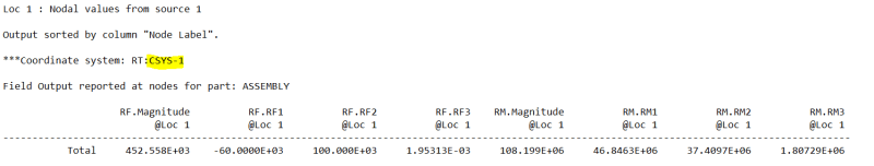

I have created new CSYS in the visualization module, with the origin in the RP1 position. I went in the results/options/transformation/user defined, clicked on csys1 and applied. Then I reported unique nodal results - column total of 4 supports - 4 RPs in which I assigned the supports.
This column total values shall give me the resultant load in my CSYS origin. Moments around this RP1 shall be the same as applied.
I figured out that, by changing the ODB coordinate system, Abaqus is not trasforming the resultant moment with respect to new origin.

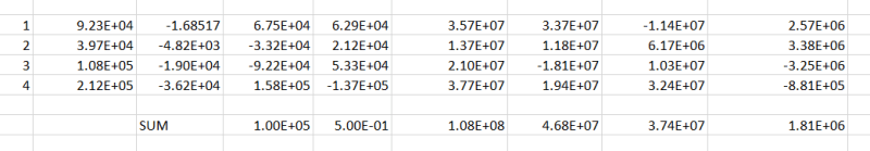

I have 4 supports. In each one of them I have some reaction moment.
What abaqus does is, just sum the moments without adding additional moment as a result of Force reaction x lever arm to the new origin.
Transformation of coordinate system is only useful when cs is rotated.
Maybe try with free body cut, there you can also select the summation point for moments.
